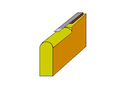

I make a gramil for every binding/purfling combination. I take a block of wood. I round one edge half way, I then take a piece of binding plus a whatere perfling I'm using and glue it to the side of the block. On top of that stack, I glue an exacto blade. I don't remember the number of the blade but it is beveled on one side and has a chisel tip. These gramils match the exact binding and perfiling because that is what I'm using to set the height of the blade.

Thanks also Mike for taking the time to draw this sketch. very good tip! Do you glue the blade at a certain angle in order to have the tip of the blade going in the sides at a predetermined length ?

[QUOTE=Serge Poirier] Thanks Tom, i'd love to see that plan, when you get back home, please post it!
Thanks also Mike for taking the time to draw this sketch. very good tip! Do you glue the blade at a certain angle in order to have the tip of the blade going in the sides at a predetermined length ?[/QUOTE]
The tool runs along the side of the guitar and I just score the top with it. I don't angle the blade because I want to be able to run the tool "down hill" just like I would a chisel. I use this to score the top just before running the binding channel cutter. I could cut the whole channel with it by making multiple passes. In that case I would set the depth of the cut by mounting the blade so that the cataliver is exactly the right lenght. Or, if I was using a tool that already existed, I'd just make the depth on the blade with a piece of masking tape.

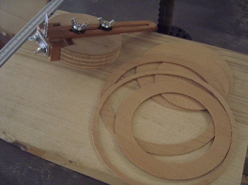

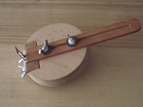

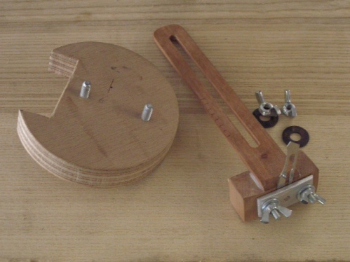

I use a brass adjustable gramil first and then my router or the Dremel depending on the kind of binding. I use a cutter to sever the grain before routing the rosette channel too. Here are picks of my home made circle cutter, it took less than an hour to make it. With this cutter I can cut both the channel and the same rosette together so the matching is perfect. If you screw any perpendicular guide (or fit a 2 inch wooden pin in a hole) on the lower side you can have also a binding cutter in the same tool.
Luigi
The complete cutter
The upper face
The lower face where you can attach an adjustable binding guide
Samples of perfect circles cut from veneersggdelazzer38798.8320138889
